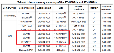

1- I think the MPU you shared belongs to the Cortex-M7 which has no effects on Cortex-M4 memory attributes as each core has its own MPU. And no need for MPU configuration for CM4 side for LWIP as there is no cache.
2- Another thing regarding your linker file:
RAM_D2 (xrw) : ORIGIN = 0x10000000, LENGTH = 288K
You set the region RAM_D2 to the sum of the SRAM1, SRAM2 and SRAM3 sizes but you are using SRAM3 for the Ethernet stuff! It could be an overlap between the stack and the Ethernet data. So set RAM_D2 size to 256K and leave SRAM3 for LWIP:
RAM_D2 (xrw) : ORIGIN = 0x10000000, LENGTH = 256K

2. "What I had understood is that memory that is not defined in the .ld file won't be used by the compiler. Is that correct?"
That's correct. But in your linker file SRAM3 is defined in RAM_D2:
SRAM1 (128kB) + SRAM2 (128kB) + SRAM3 (32kB) = 288kB which is the size declared in your linker file for RAM_D2 starting from the base address of SRAM1. And you are using SRAM3 for ETH descriptors which induced to an overlap between the data (stack etc..) and the ETH decriptor.
That's why you need to keep SRAM1 + SRAM2 i.e. 256kB for the application (RW data for CM4) and SRAM3 for LWIP i.e. 32kB.
