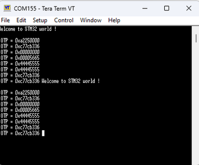

Hello @Donnie,
I did a simple check with a very simple code as you can see below:
For your Test issue:
- May be you kept the code used for programming the OTP. Because, writing twice an OTP 16-bit word will generate ECC error (NMI).
- Another hypothesis, the debugger is reading OTP regions. Debugger will read non-programmed OTP or programmed regions twice and will cause NMI as well. In this case, avoid memory view of OTPs.
In my test:
Initially, I programmed the addresses from 0x08fff000 to 0x08fff020.
Then, I read the programmed OTP with a simple for loop:
for(flash_address= 0x08fff000; flash_address < 0x08fff020; flash_address = flash_address +4)
uint32_t c_ad;
c_ad = *((uint32_t*) flash_address);
printf("\n\r OTP = 0x%08x ", c_ad);
I'm able to read the OTP addresses as depicted below:
