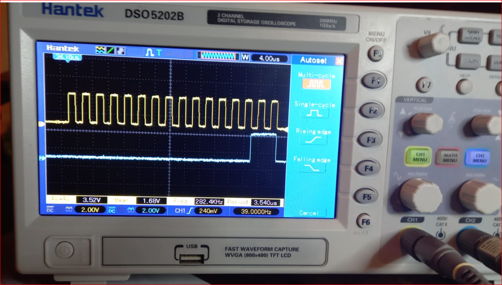

Data from Master is ok, please check the figure below:

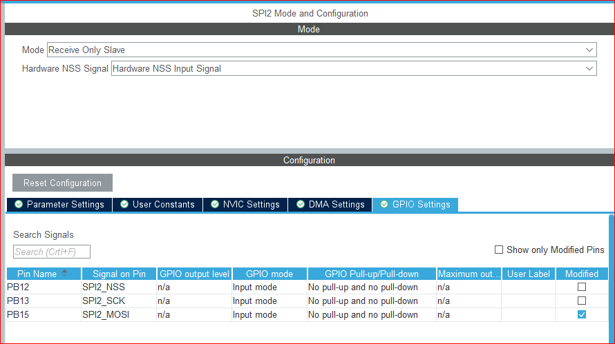

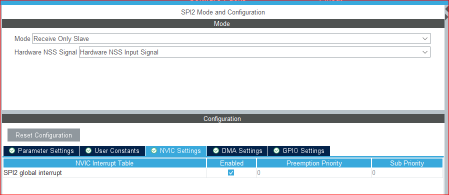

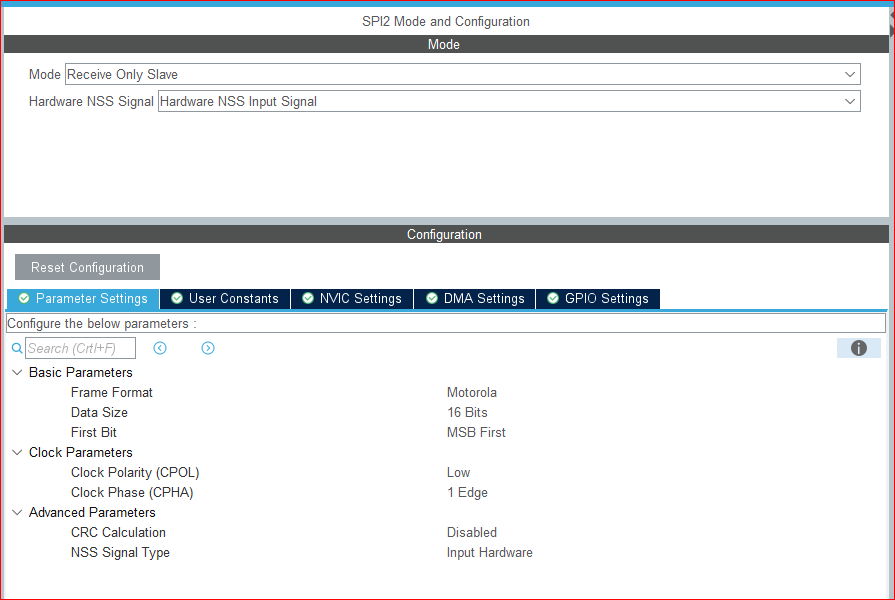

this is SPI2 configuration from CubeIDE:

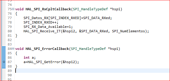

2022-01-18 9:02 AM
TDK, thanks a lot for yopur comments.
I was making some mistakes, In order to see/check if SPI was working between STM32F103 was using debuger:
if i use just one break point....in HAL_SPI_ErrorCallback, the comunitacion work fine, as there is not any error, SPI works normally...
but my mistake was set a breakpoint in HAL_SPI_RXCpltCallback, after i saw the data receved, the Error in Hal_SPI_ErrorCallBack was fire.....so as i was breaking the SPI flow (time, secuency, etc) with the Breakpoint in HAL_SPI_RXCpltCallback, later the error is reported....
So, now I am uing 16 bits between both STMs, and as just have a breakopint in HAL_SPI_Error, everything is working fine.
