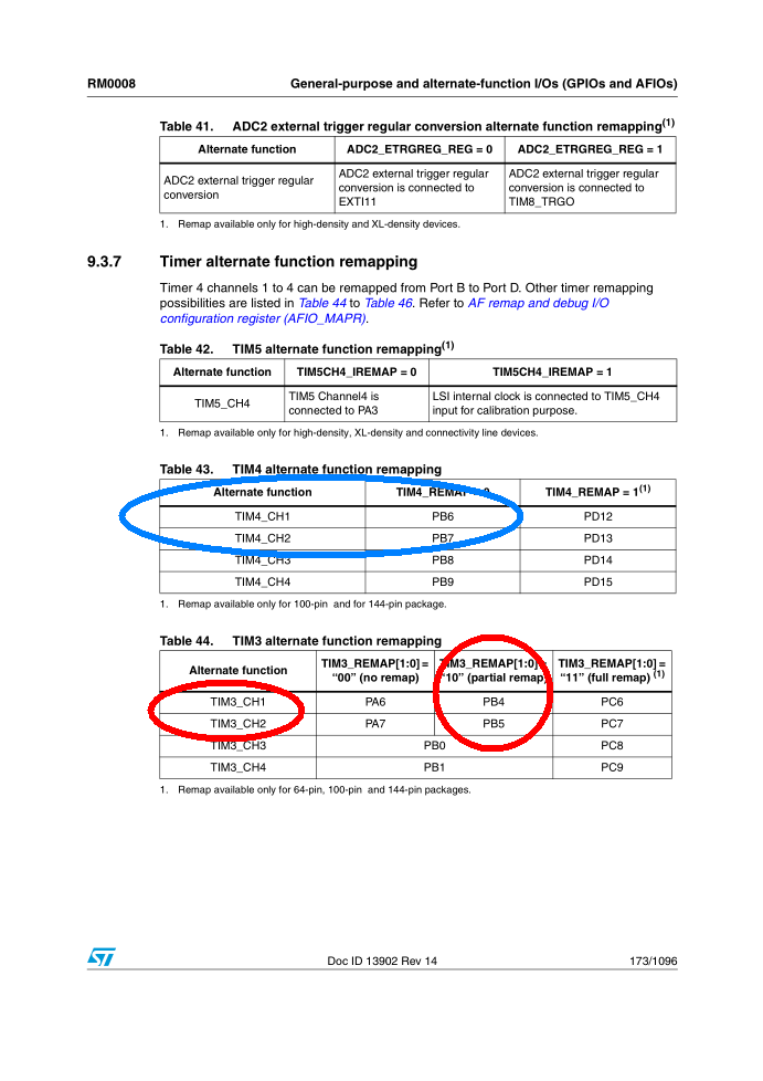

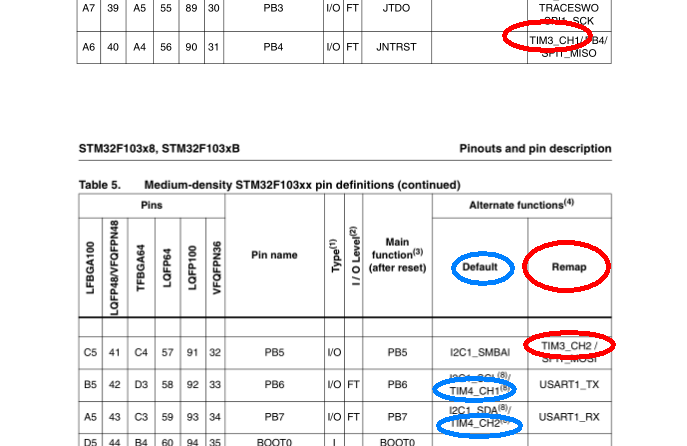

Make sure to enable the AFIO clock to allow for the Remap. The F1 design is a decade old, it had peripheral level remapping (block/group of pins), newer designs have pin level remapping.

Watch the JTAG also, might want to remap or constrict that, should be a GPIO/JTAG example in the SPL release. There's a setting to just use the SWD subset of pins, don't have the resources at hand to check.

According to what I found,
I should manage to do what I want with adding:
RCC_APB2Periph_GPIOC | RCC_APB2Periph_AFIO, ENABLE
and
GPIO_PinRemapConfig
(GPIO_PartialRemap_TIM3, ENABLE);
As i want TIM3 to be on PB4 and PB5
