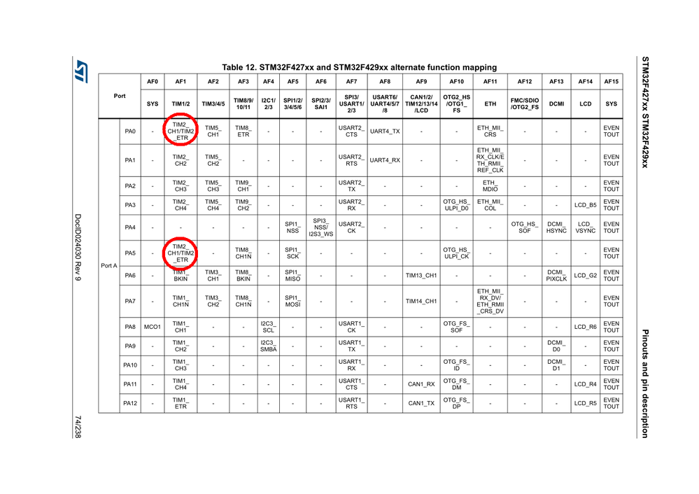

You can't assign functions to pins randomly. PG11 does not connect to TIM2_CH1 - for that you'd need PA0, PA5 or PA15. Look at the table in the STM32F429's datasheet:
etc.
