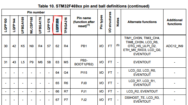

,You should review the pin assignment in the
of your product, in the (Table STM32F469xx pin and ball definitions) for the Pin number of
STM32F469BITx(LQFP208)

The definition of TS_INT pin is a software definition, any pin could be used.
DSIHOST_TE is an hardware feature, this function is only available on PJ2 and PB11 through alternate function configuration of the GPIO (see AF13 in the table 12 in the datasheet).
This is configured through the GPIOx_AFRy bit field relative to one those two pins (in
GPIOJ_AFRL and GPIO
B
_AFRH respectively)
