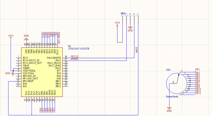

I'm connecting a 12-Way rotary switch to an STM32G071 as shown:
Board room is extremely limited, so I'm using the MCUs built in Pull Ups.
However when I read the lowest four bits of PORTD->IDR (for switch positions 7,8,9 and 10) it reads 0xA when it should read 0xF (The rotary is at position 1, so PORTD0:3 should all be pulled up).

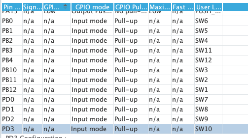

Cube MX confirms PULL UP is enabled for all switch inputs:
But does the generated code really enable all pull-ups ?
