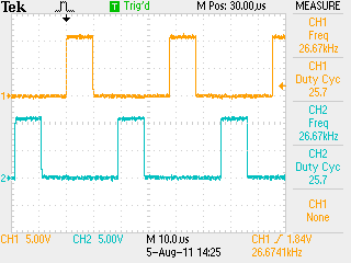

I'm using the STM32F103RCT6. I need two PWM outputs, where the period and polarity of each is the same, but one output is 180� out of phase from the other.
A duty cycle change must affect both concurrently. The complementary output configuration is close, but not quite.
I need to be able to do this:
Any ideas?

If they were in phase with opposite polarity, when one output was 1, the other output would always be 0 (i.e. complementary outputs), dead-time aside. I'm looking for a Push-Pull configuration. See this post:
https://my.st.com/public/STe2ecommunities/mcu/Lists/cortex_mx_stm32/Flat.aspx?RootFolder=https%3a%2f%2fmy.st.com%2fpublic%2fSTe2ecommunities%2fmcu%2fLists%2fcortex_mx_stm32%2fhow%20to%20generate%20pwm%20for%20push-pull%20converter&FolderCTID=0x01200200770978C69A1141439FE559EB459D7580009C4E14902C3CDE... And this one: http://www.cypress.com/?rID=354312011-08-11 3:26 PM
