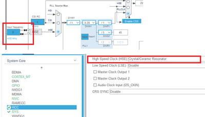

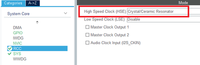

After checking your RCC clock config it seems you are configuring the HSE for Crystal/Resonator while these crystals on both Nucleo boards are not present. And I'm pretty sure your program didn't overpass HAL_RCC_ClockConfig(). See this thread.

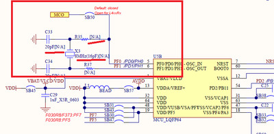

Now, you need to refer to the boards' schematics:
Nucleo-F446RE schematics:

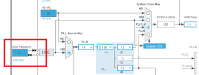

Your HSE config is set to Crystal/Resonator:

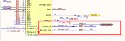

Nucleo-H723ZI schematics:

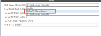

So for the Nucleo board you need to use HSE in Bypass mode:
As the external crystal is unavailable on these boards, the clock is generated from the STLINK MCO output.
For Nucleo-H723 (featuring STLINK-V3) you need to review my article in this link to configure STLINK MCO frequency output before going ahead.
For NucleoF4 there is nothing to configure on the STLINK (STLINK-V2).
