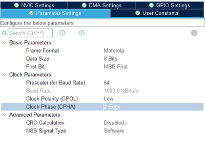

The SPI ioc configuration is as follows:

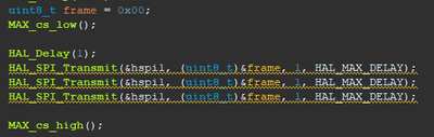

and the code inside the main function is:

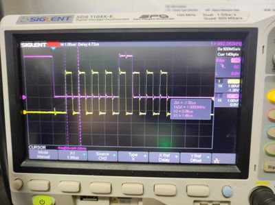

As you can see, I am just trying to send 3 bytes over the SPI where each byte should be 0x00. The issue I am having to understand is why is there a logical 1 on MOSI line the MOSI line should be in logical 0 during the transmit:
- YELLOW: CLK
- PURPLE: MOSI
So it seems like it is sending 0x08 instead of 0x00. Considering I am using HAL_SPI_Transmit (I am not using a custom function) could there be a bug in built in code for SPI?

The function wants a pointer to the data. You're converting the pointer to an integer, when is then implicitly re-converted to a pointer so the function is not sending the data you want, but the data at memory address 0. This is bad and you should be receiving warning during compilation which is why those lines are underlined in yellow.
Here is what you want:
uint8_t frame = 0;
HAL_SPI_Transmit(&hspi1, &frame, 1, HAL_MAX_DELAY);Or this:
uint8_t frame = 0;
HAL_SPI_Transmit(&hspi1, (uint8_t*)&frame, 1, HAL_MAX_DELAY);
