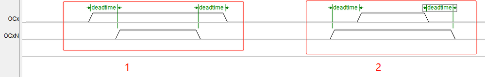

yes , above fig about two kinds of config deadtime ,I don't know how to get that waveform
I have readed RM about deadtime chapter,but I still not clear
2019-07-17 10:49 PM
You can achieve waveform 1 if you invert OCx, i.e. set the respective TIMx_CCER.CCxP .
Conversely, you achieve waveform 2 if you invert OCxN, i.e. set TIMx_CCER.CCxNP. You may also want to "invert" OCxRef, i.e. use the other PWM mode than used in the first case.
Try and see for yourself.
