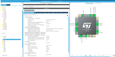

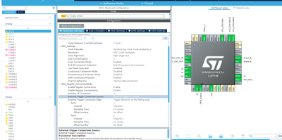

I am trying to synchronize the ADC1 and ADC2 to work with center-aligned PWM signals in dual-simultaneous regular mode using DMA. My setup:

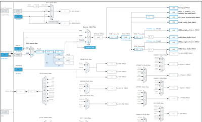

PWM frequency: 5.2 kHZ
ADC conversion frequency: 104/2 = 52 MHZ
If I have 3 conversions per ADC with every single one lasting 2.5 cycles, according to the reference manual:
One conversion : (2.5 + 12.5)*19ns = 285 ns
Three conversions: 285*3 = 855 ns

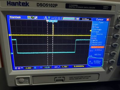

The problem is when I hook up oscilloscope I see that I am getting 8.2us until I reach my interrupt routine which is much longer than expected. I want to do all of my conversions at the moment when CNT=ARR so that I make sure lower side of the FET is ON. I am doing this by setting another channel of the timer to use it only for the time base and setting its TIMx.Pulse = ARR -1.

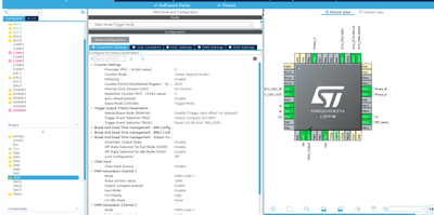

Also TIM1 and TIM8 are synchronized through master/slave in trigger mode on enabling the counter.
Picture of the scope:
Yellow : PA7 - GPIO
Blue: TIM1CH2 PWM
