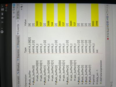

2D buffer works. Thanks!
2024-08-09 7:46 AM
can you share a code?
