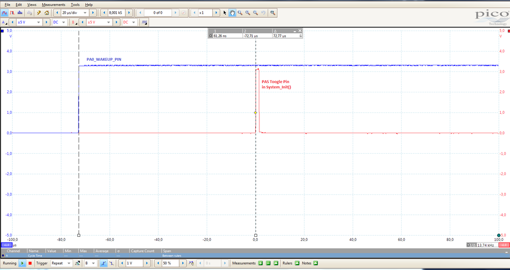

2018-12-31 3:33 AM
Here my results by using my method (PA0 as external wake-up pin on PA5 toggle into system_init()) but it should be the same by using iwdg reset. I will check it.
I capture 73µs @ VDD=3.3V with Fast wakeup enabled. And maybe need to take the code added into System_Init() to configure PA5 clock, and IO register. Maybe 20 cycles to remove at 2.1MHz. 9µs to substract ie 73-9 = 64µs

2018-12-31 4:16 AM
Great to see this, many thanks. You're doing the work in "SystemInit()" which I have in "main()". I also do not use libopen, but my own code, and it also uses direct register access. The differences, as far as I can tell, should be at most a few instruction cycles - I'll investigate further. Then again, 100 µs is not much @ 2.1 MHz, so maybe the remaining 100 µs I'm chasing should just be treated as "startup overhead".
