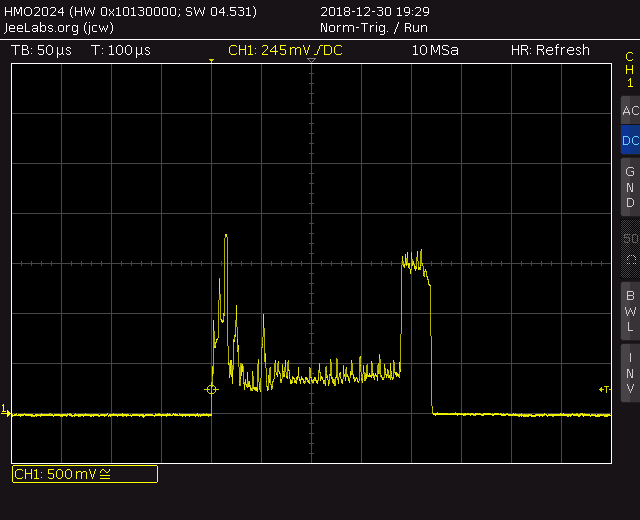

New results, and frankly, I'm not sure how to interpret them - I now get more like 180 µs delay, much closer to the expected 65 µs, and a good deal better than the 1.6 ms reported earlier.
Here is the new code, with an LED attached to PA1, so I can see when the main code starts:

2018-12-30 10:52 AM
And here's the matching scope shot with the current consumption readings:
