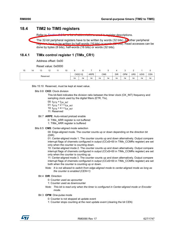

I think TIM2 on an F4 is going to want 32-bit writes.

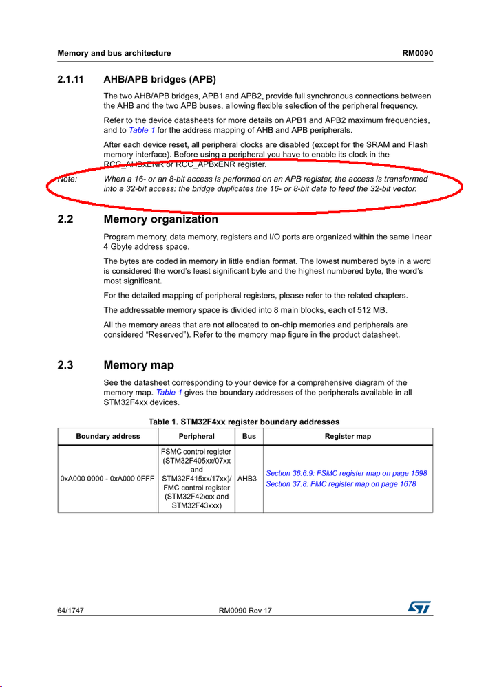

Yes that's it:
When the DMA writes 16-bits, the AHB-APB bridge doubles it.
There's no other rational solution than to have the values array 32-bit and tell the DMA to transfer words.

Hello Jan,
Thank you very much for your detailed answer and for pointing to the ref manual lines.

2018-10-11 9:46 AM
> Can we make a general rule that this doubling of 16 bit accesses applies to any peripheral that has an enable bit in an RCC_APBx_ENR?
The "doubling" happens at the AHB-to-APB bridge, so if a master (processor or DMA -other masters, DMA-capable peripherals such as ETH and OTG_HS, generally don't support other than whole word-wide accesses) writes a byte or a halfword, the peripheral sees it on the APB's data bus doubled. But - and this is a big but - the lane (i.e. which bytes are used) information is also propagated from AHB to APB, so peripherals which are 16-bit or 8-bit access capable, will use this information and will use only the respective portion of the data. To sum it up, the width of access for given peripheral's registers, which is always given at the beginning of the register's subchapter, is always to be obeyed when writing to that peripheral, be it from processor or from DMA.
> Is it the case for all STM32 families
AFAIK, Yes. Read the respective RMs if you want to be sure.
Nonetheless, as I pointed out above, the DMA in some other STM32's works differently, so the net effect of the whole DMA-to-peripheral chain may be different in different families.
> maybe even for all Cortex-Mx because it is subject to ARM IP
No. I don't know where the AHB-to-APB bridge in STM32 originated, but I suspect it's ST's own. Even if it would be ARM's, other vendors may chose their own implementation.
