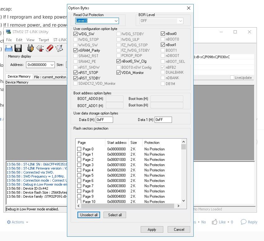

Thanks Clive, I'm lost on this one, how can I send you a pic from ST-LINK Utilities, target option byte?
maybe there is something there?
cheers

There is the state of the BOOT0 pin, and an option for BOOT1. I doubt the pin on the Nucleo is doing odd things, and you could explain the state of the options.

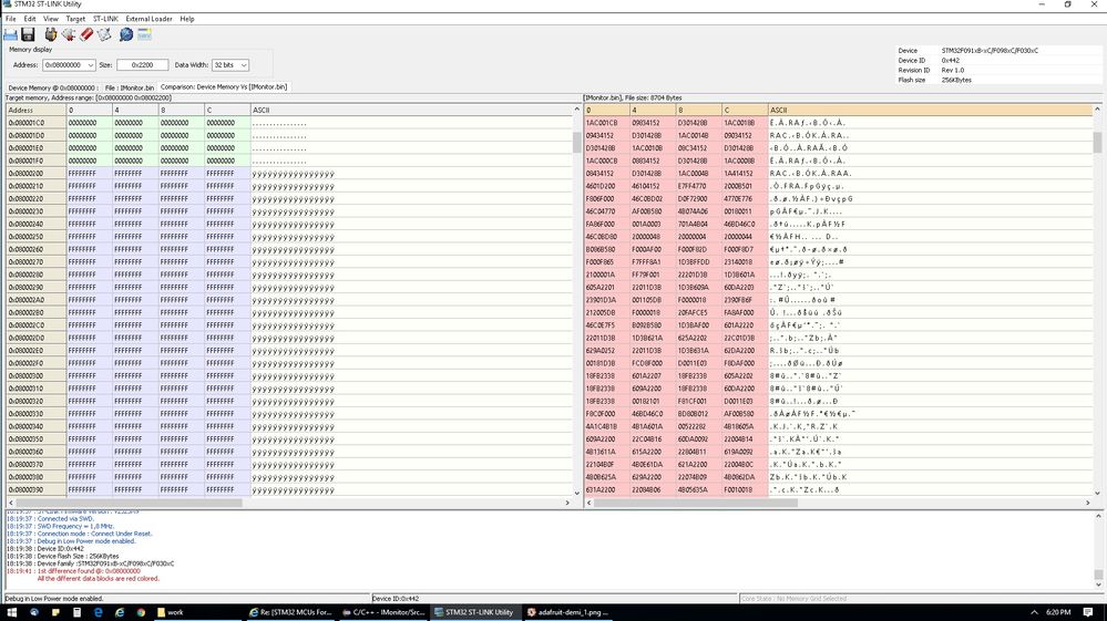

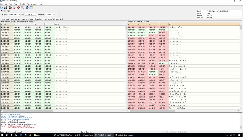

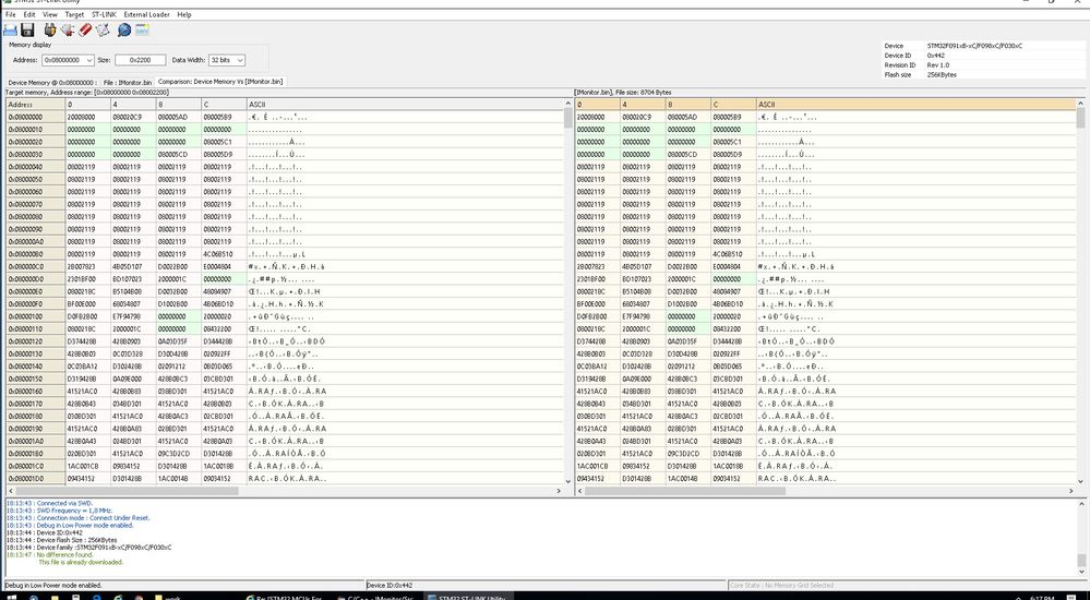

Sure Clive, I was not sure why you asked to compare flash memory with my bin file, but here is what I found.
1) newly loaded file into cpu without disconnecting and reconnecting power, file and flash compare successfully. See pic
2) When I disconnect power, and reconnect power, then I perform a device memory with bin file compare, then it fails, flash and device memory are not the same, large chunks at the start of flash seem to have bee erased. See pics I haven't trolled through the data sheet as yet,.... do I have to, it should work straight out of the box?3 pics below, of success & failed compares.
Does this mean anything to anyone familiar with this cpu series, or perhaps programmer issue??
