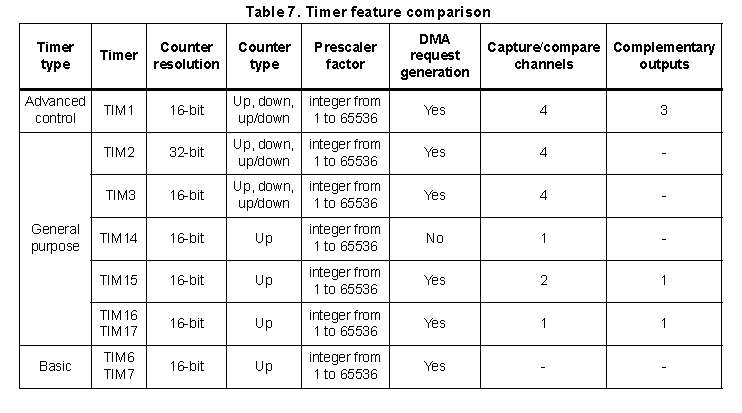

16 PWM output channels could be achieved with 4x TIM with 4x channels. Make sure you understand the STM32 to determine if the frequency/function you want to implement can be done the way you want.

The peripheral selection filter when creating a new project will help reduce the number of datasheets to read:
- select the number of timers: 4 or 6 (the STM32 often has at least 2 timers with 1 or no external channel)
- check the Touch sensing box
This should already reduce the number of documents you have to read...

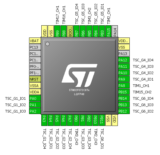

At this point the datasheet will help to choose the package. It usually show the number of touch channels and the number of PWM channels
Then, you can also review the pinout in CubeMx because there is no guaranty that the PWM and touch sensing function are available simultaneously: they may share the same pin...
here an example:
