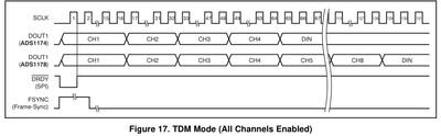

Sure. It's a TI ADS1178. We're using a pair with fixed TDMA on a single SPI bus, so 16 channels @16bit each. Hench 32 bytes.
Absolutely looking to do the considerably more work route, but I need a working example to work from. Can get a single transfer no problem. Can get continuous with DMA. Can't get continuous 32byte transfers.
Here's the timing on the SPI / nDRDY line from the ADS1178 manual:
