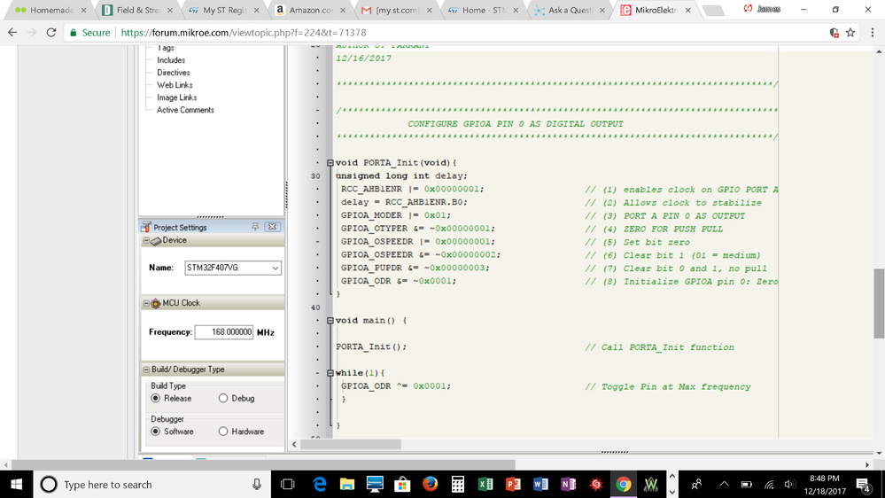

I am using the Mikro Pro C IDE to write a simple program to toggle GPIOA pin 0 on a STM32F407VGT6. When I compile I get several errors, but I don't think it has to do with an error in my code, more or less a problem with the IDE I'm using. Hopefully someone can take a look at the program attached and verify the code looks correct.

You mean in the screenshot image ?
The usage of the constants and bit definitions in ST's device header (stm34f4xx.h) would make it more readable than magic numbers written into registers.
