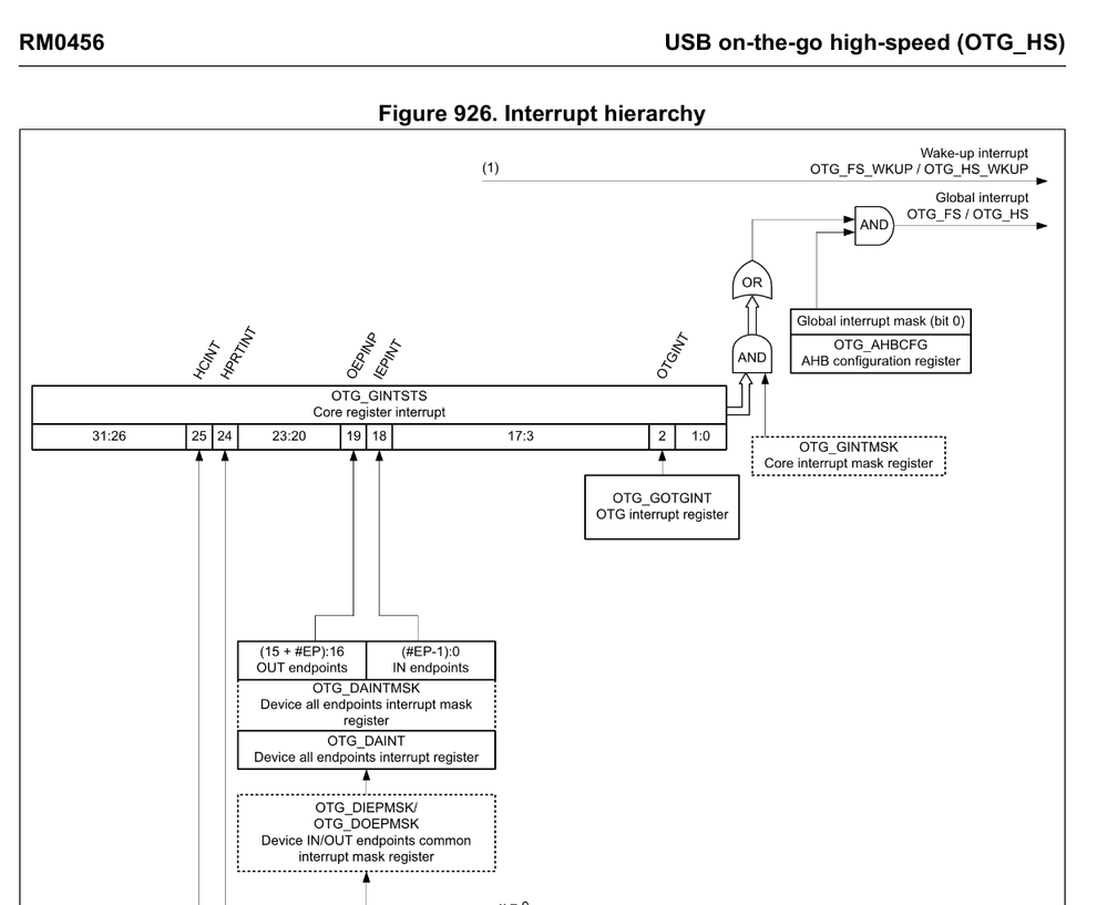

However I checked the RM0456, which is referred to the STM32U5 series MCUs and it shows the the OTG_FS_WKUP / OTG_HS_WKUP line.
2025-06-19 6:53 AM - edited 2025-06-20 3:46 AM
Hi @j_filipe
In footnote, it is noted:

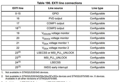

1. OTG_FS_WKUP becomes active (high state) when resume condition occurs during L1 SLEEP or L2 SUSPEND states.
This is not direct EXTI wakeup.
You can refer also to Table 190: EXTI line connections: we don't have direct USB wakeup over EXTI on STM32U5.
