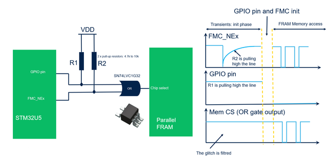

Anyway, it's under analysis and will update you as soon we have any news. I don't know how it will take but if you are hurry, I can propose the following as a workaround (you need to test it):
2025-11-03 5:07 PM
Thank you for the suggestion. We have implemented similar Logic on FRAM CS and it is working.
