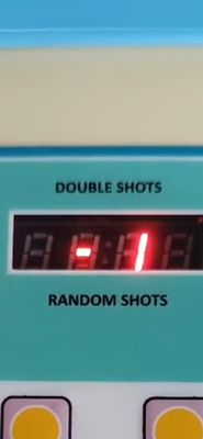

The product includes a seven-segment LCD. After programming the firmware and running tests, I noticed that some characters do not display correctly in certain menu screens. I’m confident this is not a hardware issue. Interestingly, when I reflash the firmware on the same board, everything starts working properly — the display shows the correct characters.

Shouldn't we see that the code is stuck somewhere in the code and all of them? Additionally, as I mentioned, I can see that some characters on the LCD aren't working. I even log the number of times the device has been activated. Deleting everything and reinstalling it fixes it, and the device that doesn't work displays a 0. Sometimes, when we reinstall it, it displays a -1.

@oguzhansenol wrote:the LCD ... displays a -1.
That looks more like LEDs ?
