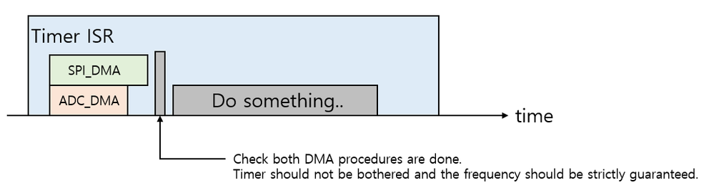

I thought it can be done parallelly like the follows:
"Do something" needs two data from ADC and SPI, therefore
it has to check if both works are done and move on to the Do something part.
The problem is :
I tried to make the priority of timer lower than DMA interrupts,
and use the while() loop in the timer to check the DMA status.
but it doesn't work properly, I think while() loop blocks and bothers the timer so the frequency is not guaranteed..
Could you please give me some advice to achieve this kind of thing?

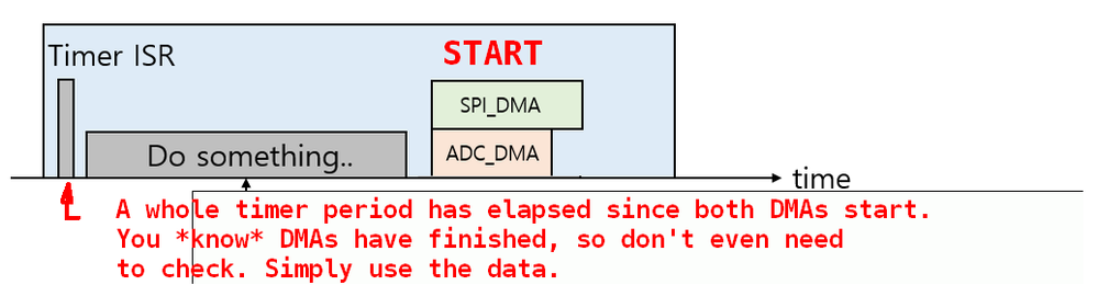

2022-01-19 7:05 AM
Sorry, the text lies - it's not a *whole timer period* but timer period minus duration of "Do something".
If time between end of timer ISR and beginning of the next is not sufficient to both DMAs to finish, use double-buffering - start the two DMA at the beginning of TIMER but alternate between two buffers into which the DMA goes, and in the "Do something" use the other buffer's content.
And even if you'd wish to check whether DMA finished, you don't need any DMA interrupt for that. Simply check the DMA status flags.

2022-01-19 8:56 AM
2022-01-24 1:05 AM
Hi all,
I have a little progress, thanks to TDK and waclawek.jan!
The concept which like the diagram I posted, works fine now.
