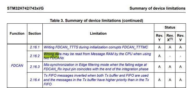

with our current project we have to use both CAN interfaces and I'm actually unsure about how to understand the errata sheet and information in this thread.
The actual errata sheets for the STM32H743 and STM32H753 list devices with the device marking V and accordingly REV_ID 0x2003 as affected variants.

2022-01-24 1:38 AM
Hi @MBC ,
According to the table 3 in the STM32H743xI/G Errata sheet (ES0392 Rev 8) : this FD-CAN limitation is absent from the revision V.
Hope that I've answered your question.
Thanks
