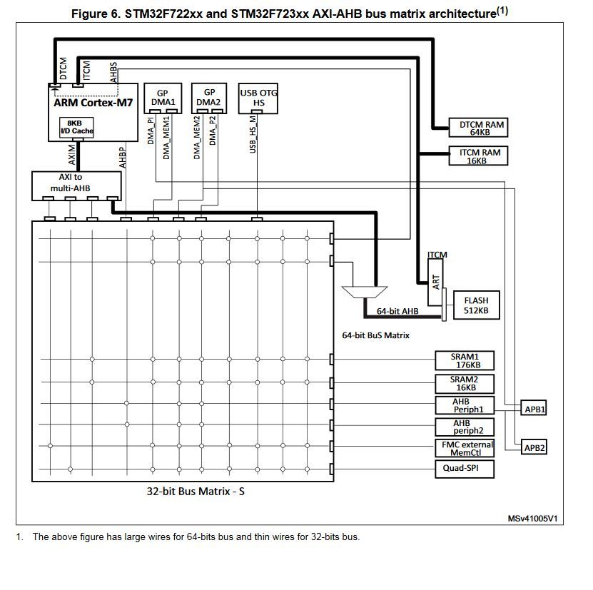

I want to run 2 DMA's simultaneously. One which will send data out using the SDMMC1, which is linked to DMA2. Then I'd like to read in data using DMA1 connected to Either of the Timer peripherals that allow a DMA request from GPIO to memory. Which here would be for example Timer 2 of DMA 1 stream 1.
It doesn't seem like I can read in data from the GPIO to memory using DMA1 as seen in the image below from application note an 4 I've read on some forums that this could be because there is no direct connection between the DMA1 P and the bus matrix. So It would require me to go through a direct path. Is this possible as I haven't been able to get this going?

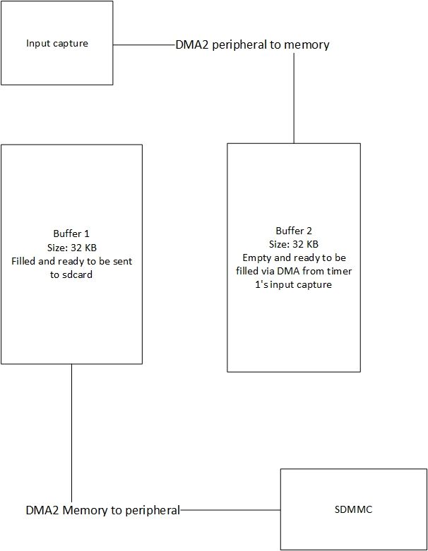

This portion has got me slightly confused. I think this is what is meant here:
As in the drawing, I should use two buffers, when Buffer 1 of size 32KB is full it needs to be sent to the sdcard and Buffer 2 gets filled via the dma with every input capture? Wouldn't this still be an issue as the DMA will be busy sending out data to the SDMMC and miss triggers to load data into buffer 2 from the input capture. I might completely be misunderstanding what you meant. I'm not sure if your hinting at RTOS with the singular thread. But if there's anyway that I can get Buffer 2 to fill while buffer 1 is being emptied, I'd be extremely happy

It's not clear you'll miss samples. The DMA+CPU share the resources, and take turns, contention is at a unit transfer level. Both ADC and MMC would throw under/over run errors if the peripheral isn't serviced in a timely manner.
The idea of the spill buffer is to try to reduce the number of unnecessary copies. Ideally you'd have a pair of equally size ping-pong buffer, which alternate so you can write the inactive half.
With 192 samples (384 bytes), that doesn't fit cleanly into 32768 (you want binary multiples, matching the blocking device)
A spill buffer would describe 32768 + 384 bytes, every time you have 384 bytes ready you copy into the buffer. Logic detects >= 32768 available and flushes that to the media. You then look at the excess, pulling it to the front of the buffer.

Thank you for the help. I'll do this and after looking at the ref manual I can see that I'll get a FIFO or direct mode error(if FIFO isn't enabled) if I miss a sample(i.e the DMA is triggered multiple times without access to the bus matrix).
I just maybe have a solution that I've though of if I test and its not fast enough(which I'll be doing today or tomorrow).
Could I use the Double buffer mode with one buffer in SRAM1 and one buffer in SRAM2 and by doing this have concurrent read and writes?
From this image from the datasheet it looks like the CPU would be able to reading from SRAM1 while the DMA is writing to SRAM2. Without any collisions occurring.
