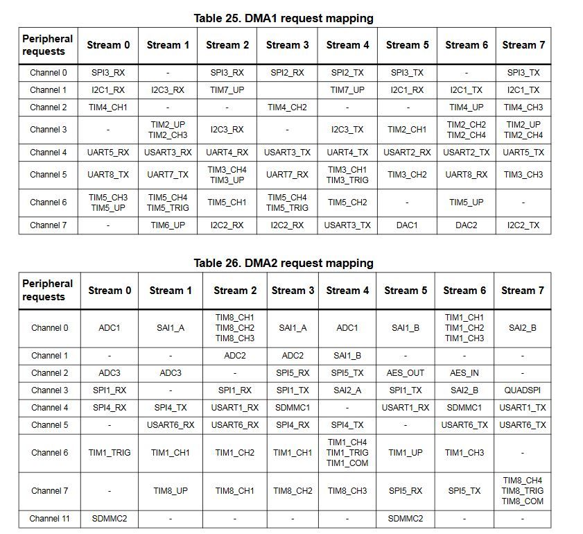

I want to run 2 DMA's simultaneously. One which will send data out using the SDMMC1, which is linked to DMA2. Then I'd like to read in data using DMA1 connected to Either of the Timer peripherals that allow a DMA request from GPIO to memory. Which here would be for example Timer 2 of DMA 1 stream 1.

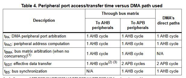

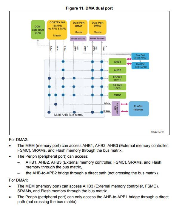

It doesn't seem like I can read in data from the GPIO to memory using DMA1 as seen in the image below from application note an 4 I've read on some forums that this could be because there is no direct connection between the DMA1 P and the bus matrix. So It would require me to go through a direct path. Is this possible as I haven't been able to get this going?

what the direct path is that they refer to in an4031
That's when you access a peripheral through the dual-AHB/APB bridge (ie. when on the peripheral side of DMA, you use an address within its 'respective' APB address range).
This is the only option in DMA1. In DMA2, the other case - when you access APB through the bus matrix - happens if you access one of the APB1 peripherals from DMA2.
2018-01-24 12:30 PM
You can't use DMA1 for GPIO-to-memory access, fullstop.
You can have as many streams enabled simultaneously on DMA2 as much you want. They don't work simultaneously, but they follow the priorities assigned and natural, when several are triggered simultaneously.

2018-01-24 12:43 PM
The Figure 11 seems to describe an F4 part, but your post more generally is about the F7
Some contention will occur due to the cycles involved, the system should manage most of these situations (check errata)
Both DMA1 and DMA2 have 8 independent internal units, so the system should be able to juggle 16 concurrent DMA operations.
2018-01-24 2:03 PM
The 'F7 have very same arrangement of the two DMA units as the 'F4, AFAIK. There may be details such as one, two or three RAM slave lines in the matrix, and DMA1 can connect to just several or all of them on its memory port, but IMO that's immaterial for this discussion.
2018-01-24 2:35 PM
My issue here is two fold, 1) mixed documentation is being reviewed, best to stick to the one for the platform being used lest wires get crossed or more confusion created, 2) ST has an F4 diagram in F7 documentation.
2018-01-24 3:29 PM
I see your point, Clive, however...
That Fig11 is from AN4031 (I did not realize Piet has already read it, sorry) and that appnote pertains to all 'F2, 'F4 and 'F7 (it says so in the title of AN, and also in the very chapter that Fig. is from). It serves as an illustration. Yes, it might've been made more 'generic' quite easily - yet highlighting the point, that DMA1 has access to a selection of memories on its memory port, i.e. no access to the peripheral AHBs there (thus no access to GPIO which on 'F2/'F4/'F7 sit on one of the AHBs); and no access to the bus matrix at all on the peripheral port - whereas DMA2 has it all.
This is just another 'proof' that the DMA arrangement is the same, although I admit there are DMA-related issues specific to 'F7 (user has to realize DMA-initiated operations are invisible to the cache; the DTCM is accessed through the APBS 'bridge', maybe there are more - I don't use F7 actively.)
2018-01-26 4:39 AM

2018-01-26 4:55 AM
Hi JW,
Firstly thank you for the reply.
I completely agree , although would you mind explaining what the direct path is that they refer to in an4031? I can see it throughout the application note.
I'll try to calculate the clash on the bus using an4
Thank you for all the help
2018-01-26 5:05 AM
My understanding is that this can't happen simultaneously. One will occur and then the other?
The processes are more complex than this.
First, the memory-to-peripheral is influenced by pre-reading into FIFO.
Second, the arbitration happens at the memory and peripheral port separately.
Third, there may be processor or any other matrix-master accesses during the process, potentially fighting for slots on the target buses.
2018-01-26 5:09 AM
