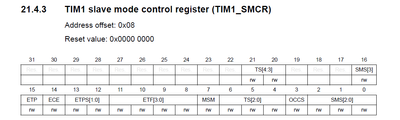

Here is my SMCR register contents for "Combined Reset + Triggered Mode" and TIFP1 Trigger Input

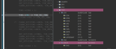

Here is my Timer 1 CR register, I am now at the point where I want to do a software pulse.

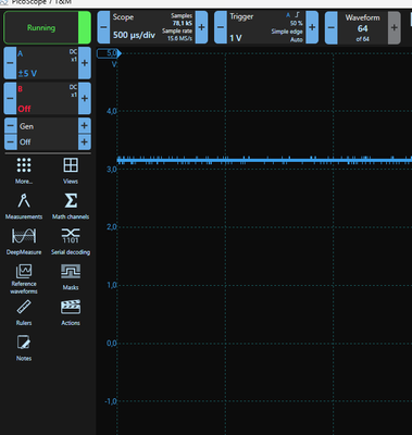

Here is my timer output on the scope. Bear in mind I've got an internal Pull-Up enables.
I've got the pin in Tri-State Mode, so High will be 3.3V and Low will be ~0V. When the timer triggers, my io pin must be low.
I've got my debug registers set to freeze timer 1 for debugging purposes.
Look what happens now if I step over the code.

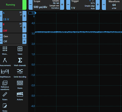

I've got the CEN bit Set. But my output still remains at 3v3.
Here is the output:

Looking at the screenshot of the TIM1_SMCR register;
* SMS= 1000 corresponding to Combined reset + trigger mode - Rising edge of the selected trigger input (TRGI)

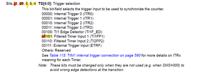

* For the TS value, TS =0x0 corresponding to internal trigger 0 (ITR0)
Given that you want to use the "Filtered Timer Input 1 (TI1FP1)" as the trigger input, you should set the TS[4:0] bit-field to "00101" as described in the RM:

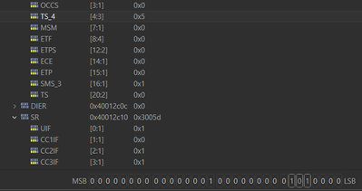

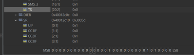

Here is my code for the trigger selection bits.
This is in accordance with what is in the datasheet (unless there is a mistake in the STM32Hal.h) constants.
As you pointer out. Now I can show you the result of this.
So we have "101" from TS_0 - TS_2 . Which is correct.
This is the TS_3 and TS_4 bits in my debugger.

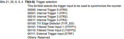

Now, ok Ignore the TS_4 Label in the SFR's and the other stuff I'm gonna show you what the manual says and you will see that my register corresponds exactly to what I want, meaning there is no mistakes.
See the Yellow is what I showed you in the first picture of my registers and the Orange is the second picture I showed you of my registers.
