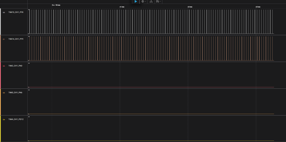

Hi @dlewis
I started from 0 as pulse period as you suggested, then I changed the periods for TIM13 and TIM14 as follow in accordingly in the while(1).
MX_GPIO_Init();
MX_TIM13_Init();
MX_TIM14_Init();
/* USER CODE BEGIN 2 */
HAL_TIM_PWM_Start(&htim13, TIM_CHANNEL_1);
HAL_TIM_PWM_Start(&htim14, TIM_CHANNEL_1);
/* USER CODE END 2 */
HAL_Delay(4000); /* no output signal as pulse = 0*/
while (1)
period1 = (period1 + 100) % 900;
sConfigOC.Pulse = period1;
HAL_TIM_PWM_ConfigChannel(&htim13, &sConfigOC, TIM_CHANNEL_1);
period2 = (period2 + 200)%900;
sConfigOC.Pulse = period2;
HAL_TIM_PWM_ConfigChannel(&htim14, &sConfigOC, TIM_CHANNEL_1;
HAL_Delay(3000); /* delay to follow changes*/
} /* while 1*/
/* USER CODE END 3 */
I can see that the wide of the pulse is changing using a logic analyzer.
Can you add the other timers and check if there is any issues?

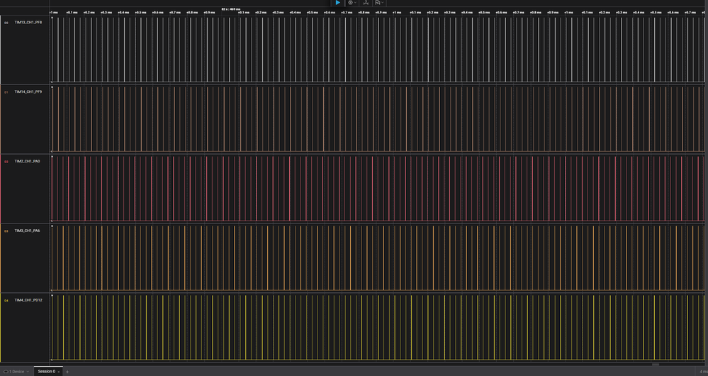

2025-05-15 6:43 AM - edited 2025-05-15 6:45 AM
Hello @dlewis, I tested the PWM output of all five timers simultaneously using a Nucleo-H563, and everything appears to be functioning correctly on my end:
When I tried using only TIM13 and TIM14 outputs, I encountered an issue where only the second timer initiated with HAL_TIM_PWM_Start was generating an output. However, rearranging the order of instructions—starting PWM TIM14 before TIM13—resolved the problem!
then, when I reverted to the original order (starting TIM13 before TIM14) it continued to work, which is quite puzzling!
It would be interesting if you could try this on your end! while I try to further investigate the order behavior.
Thank you
