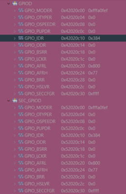

Can you please check/post also the relevant GPIO registers content.
2025-04-23 11:49 AM
Hi, apologies again for a late response. Here is the register values for GPIO port D.
2025-04-27 9:43 PM
According to the STM32H562 datasheet, there is no TIM13 nor TIM14 pin at GPIOD.

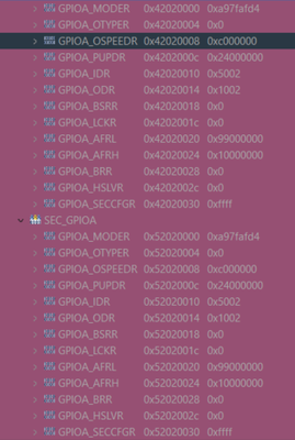

2025-04-29 11:03 AM
My apologies, I was looking at the port for the wrong PWM peripheral pin I was using. Here is the port values for GPIOA which should be the correct port.

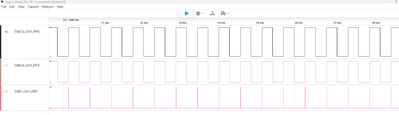

This is a test involving TIM13, TIM14 and TIM1 channel 1.
