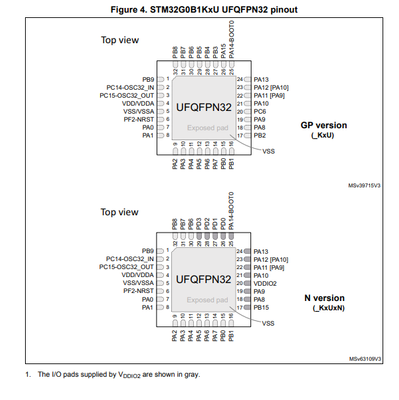

> I cant use the GPIOD, VSSI02 is on 3.3V. Im using stm32g0b1kb
The stm32g0b1kb doesn't have PD1, PD2 or PD3 pins, or any pins on GPIOD. Pins that do not exist cannot be used and will not function as expected.
2025-12-04 6:43 AM
It looks like there are several chips that start with STM32G0B1KB and some of them have VDDIO2, some not. Probably you are using the wrong one.
What is the full part number of the chip you are using? What is printed on the chip itself?

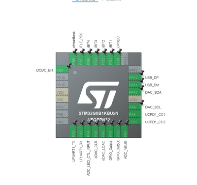

STM32G0B1KBU6N
As in the datasheet, there is a GPIOD and in the chip config you can clearly select the GPIOD

these are the versions:
You can use the GPIOD pins.

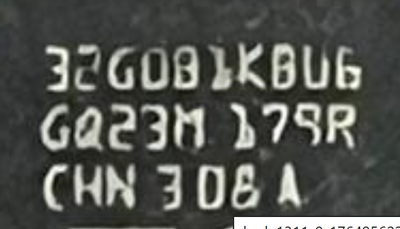

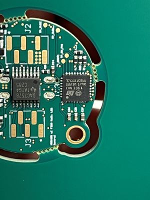

Maybe your chip is not what you think it is. Maybe it's the other version. Can you show a clear in-focus picture?
Shouldn't be hard to get pins to be able to read. Does pin PC6 show up as logic high? Would indicate the incorrect chip.
2025-12-05 9:37 AM
Waht is the difference between KBU6 and KBU6N?
2025-12-05 9:51 AM
Looks like a STM32G0B1KBU6 to me, not a STM32G0B1KBU6N. That exactly explains your problems.
The different between the two is the pinout. The chip you have has no PD1-PD3 pins as shown in the first reply. @AScha.3 also shows the two pinouts in the reply above.
