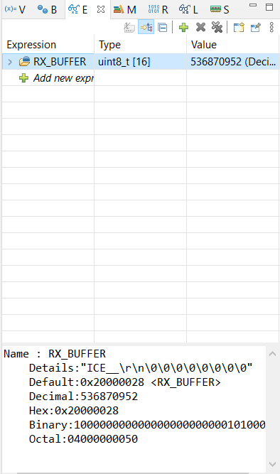

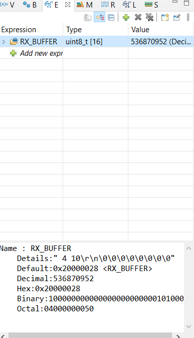

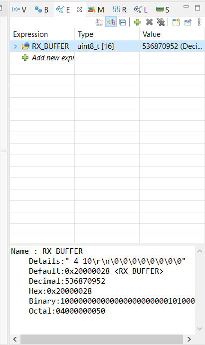

I am using an STM32G070RB nucleo 64 board with an ESP 8266, earlier I was using DMA to establish UART communication between the ESP and STM32, but now I have switched to UART interrupt mode to receive and transmit data. When I software reset the ESP the UART starts behaving unexpectedly, The commands in the RX_BUFFER are changing, however they are only part of the commands which I have sent from the ESP via UART as a result of which the device does not behave properly. Prior to software reset the device works fine.
Can someone please explain the reason for this and how to solve this issue.
