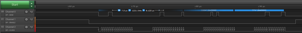

I have it working now.
The issue was that the clock has to go high after each packet. I may have also been sending the wrong packets for it to work.

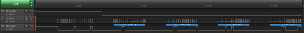

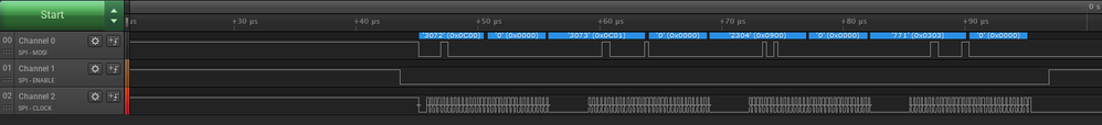

The problem is that the MAX7219 chip doesn't work (change state at all). I've tried several of the LED displays I have with this chip and none work. It doesn't even turn on or accept any of the commands, it seems. I tested the same commands on an Arduino SPI and it worked fine. So it's something I am doing wrong with the SPI on this STM32 chip.
The example compiles and if I write 2 as an argument instead of 1, then it outputs 32 bits instead of 16. I have verified that with both a logic analyzer and oscilloscope.
The example below shows where I send 1 byte. The clock pulses 16 times and it does send the full packet each time.
If I change it to 2 bytes, then I get 32 clock pulses and it sends invalid data.

Your SCK line should be idle low according to the datasheet, but the logic analyzer shows it high as you lower CS for the first time. Transmit a dummy byte with CS high first to get it into the correct state, then do CS low and send the commands you care about.
Data should be latched on the rising edge according to the datasheet. Your logic analyzer is latching data on the falling edge.
2020-08-07 11:26 AM
I tried that but it seems to have no effect. The latching issue seems to have been from the clock not being low when CS goes low.
