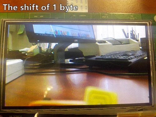

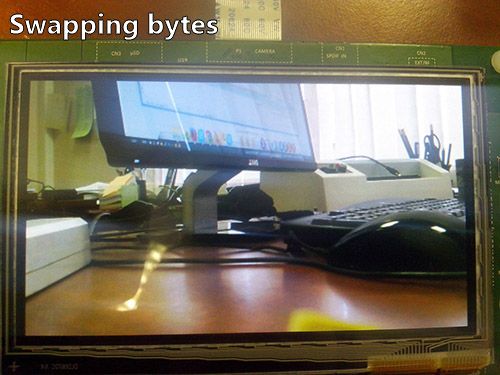

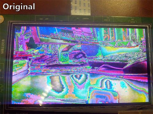

I have some problems with camera. At reception high and low bytes change places. It's make bad image (picture 1) First I think that I lose a first byte and by myself shifted a buffer on 1 byte. So, I got an acceptable image. but it has low quality (picture 2, there you can see green lines). After I reordered each high and low bytes in pixel and I got what I whant (picture 3). But is there no way to do it by DCM or DMA? There must be solution. I ask your halp with that. There is my initialization code:hdcmi->Init.CaptureRate = DCMI_CR_ALL_FRAME;
