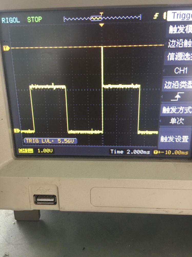

Hi everybody!Recently I found a strange phenomenon that there was a peak on the rising edge when I using the TIM1's 4 chanels to be PWM output mode.And the maxium peak voltage can reach to 5.6V measured by the oscilloscope.But the maxium voltage supplied for the MCU was just 3.45V measured by the same oscilloscope.
So where was the 5.6V peak voltage from?Please help me!

Inductive load?
2017-06-15 5:06 AM
Or another artifact, related to scope / probe impedance.
Otherwise, it would be persistent (with every rising edge).
Does it disappear when you zoom in (record with higher sampling rate) ?
2017-06-15 5:27 AM
Thank you for replying.I have tried zoom in or changing the probe impedance but the peak always exited.And I measured 3 different board with differrent cicurt,the phonomenon exits always.
2017-06-15 5:29 AM
I measured the wave when the PWM pin was not connected to any load.
2017-06-15 6:17 AM
You may check the voltage by a DMM first, is it 2.8V (suppose really 5.6V square wave).
I had been fooled by xx-Instek oscilloscope's certain malfunctioning channel.
2017-06-15 7:50 AM
Are you certain you are making a 'single ended' measurement with a common 0V between your circuit and the oscilloscope?
2017-06-15 8:05 AM
Is there >3.3V on any other pin of the mcu?
2017-06-15 8:59 AM
Select less aggressive slew rate (IO Speed), ie use the 1 or 2 MHz settings, not the 50 or 100 MHz ones
Poor grounding, pretty sure it's not coming from the STM32F1 inherently. Plot the VDD vs VSS on the second channel of the scope.
