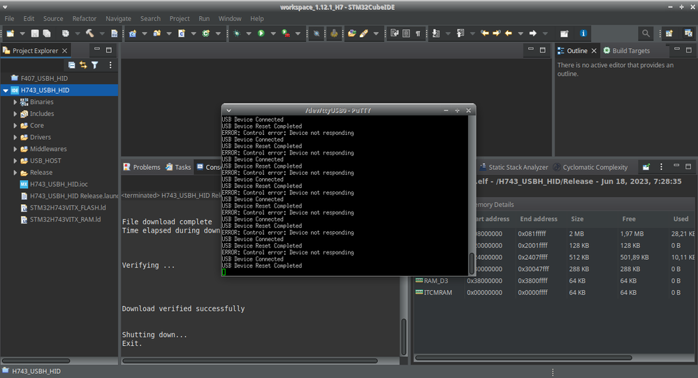

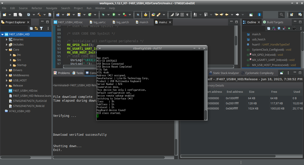

I generated a new project in STM32CubeIDE for STM32H743VIT6, as I have already done for STM32F407VGT6 for some years.
But the keyboard was not recognized by STM32F743VIT6.

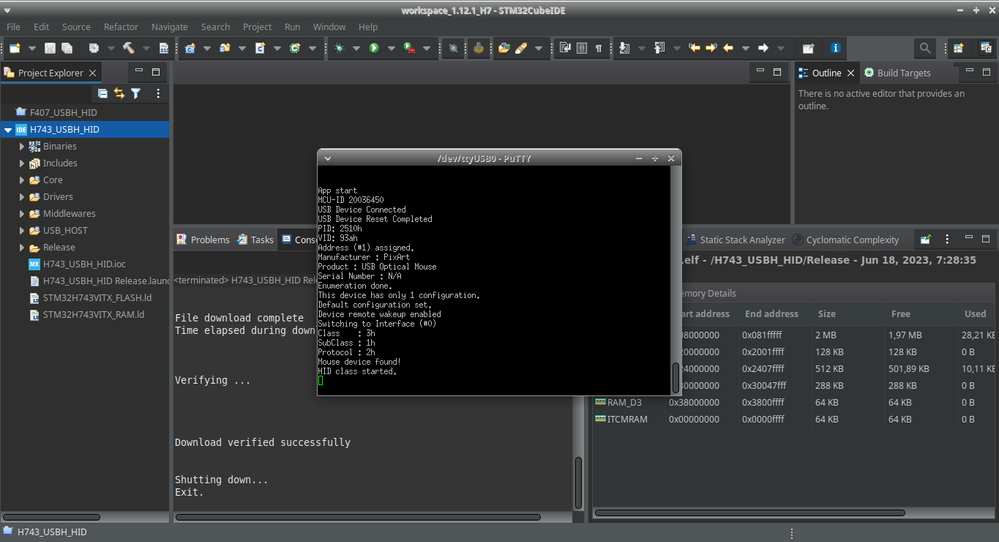

I know that STM32F743VIT6 is working because it can recognize the Mouse.
There's probably some difference in the Class codes, it's nice to get that right, as the keyboard should be the first thing anyone will try with the USB Host.
