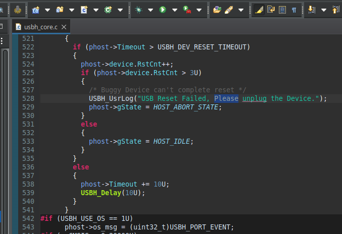

I noticed that there are debug messages advising to disconnect the device from the USB port.
I've tried de-initializing and initializing the USBH via the HALL functions, and it seems to have helped to get it working again, but it didn't completely resolve it. Completely resetting the STM32 using the "NVIC_SystemReset()" command re-established communication most of the time.
I thought of programmatically resetting the value of all CSR registers (Core global control and status registers - Ref.: RM0090). Could this work as a reset of the OTG PHY module?

Oddly DeInit doesn't seem to DeInitialize completely, this does not use the USBH_LL_DeInit function:

I modified the way of managing timeout and port reset as well, it was a bit better.
But with the reset commands via RCC the USB module seems to have managed to recover every time it crashed, I hope I'm not celebrating too soon.
