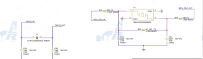

Anyway, what's the use of resistor R20?
2026-01-28 8:06 PM
The external clock is indeed 8 MHz. R20 is NC and no resistor is connected to it. When I tried the clock frequency at 80 MHz, the system would frequently enter the void HardFault Handler (void).

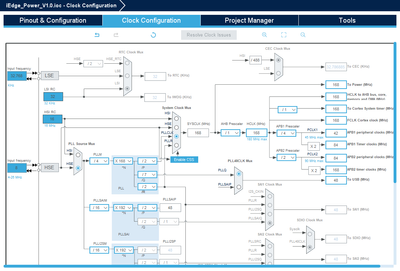

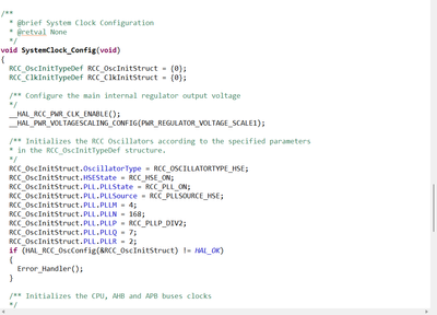

Your clock intitialization looks like 100% autogenerated by CubeMX for 180 MHz.

R18 should not be there.
Crystal appears to have 20 pF load capacitance so load capacitors should be about 2 * (20 pF - 5 pF) = 30 pF.

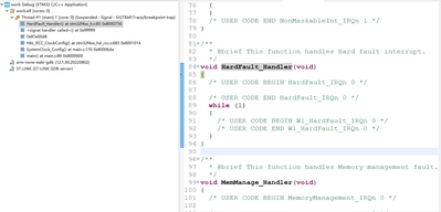

What does the hard fault analyzer say is the reason for the hard fault?

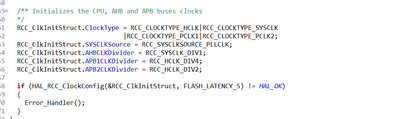

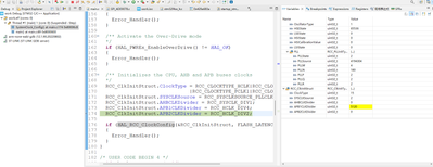

When I was conducting a single-step debugging, I reached the line: if (HAL RCC ClockConfig (&RCC ClkInitStruct, FLASH LATENCY 5)! =HAL OK) At this point, he directly entered the "void HardFault Handler (void)" section.
The clock configurations were all generated by CubeMX. I didn't make any changes and I'm not sure what the reason is.

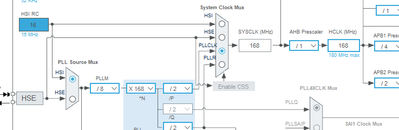

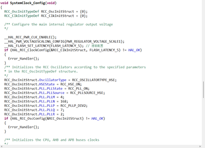

As shown in the above figure, this is the clock I configured with CubeMAX. The external clock is 8 MHz and the main frequency is 180 MHz. Then the code generated by CubeMAX is as follows:
phenomenon:
The clock is configured correctly and there is no reason for the code to crash in the "HardFault_Handler" function. However, when the configuration is set to a lower frequency, the code can run normally.
cause:
The "bus wait" for Flash read operation is not effective.Although you have set FLASH_LATENCY_5 in your code, there might be the following issues at high frequencies: __HAL_FLASH_SET_LATENCY() is executed too late (for example, after PLL configuration but the Flash has already been accessed at high frequency);The Flash voltage calibration of the chip has not been completed, resulting in the "actual non-effectiveness" of the 5 wait cycles configuration.
The solution is as follows:
Move the Flash wait cycle configuration to be performed before the PLL configuration (modify SystemClock_Config()).

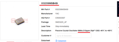

Hello @乒乓 ,

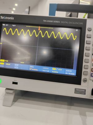

I have a doubt regarding the measured frequency value with the oscilloscope here. 8.32MHz with a crystal of +/-10PPM!
Your oscillo screanshot:

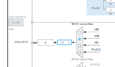

So Could you please do two tests:
1- Measure the clock on one of the MCO outputs:
Example:
Do you get 8MHz?
2- Run your code with HSI at the same system clock frequency with the same flash latency. Do you get the same issue: getting a hard fault?

Yes for me this 8.32MHz was immediately suspected. But if it really simply enought use without OC at 168MHz. By the way I did overclock NUCLEOF446 up to 240MHz it was work without any problem.
