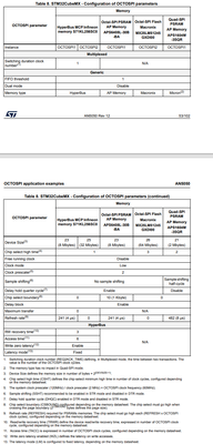

Hello @dhAvionics,
You can find more details about the XSPI settings description in AN5050 Table 8. STM32CubeMX - Configuration of OCTOSPI parameters.
Could you please try to decrease the XSPI frequency. Is the issue solved?
Thank you.
Kaouthar

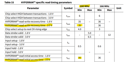

2026-02-09 12:05 AM
Hello @dhAvionics ;
Could you please check RW recovery time and Access time.
Read/write recovery time (TRWR) define the device read/write recovery time, expressed in number of OCTOSPI clock cycle, configured depending on the memory datasheet.
Access time (TACC) is expressed in number of OCTOSPI clock cycles, configured depending on the memory datasheet.
Thank you.
Kaouthar

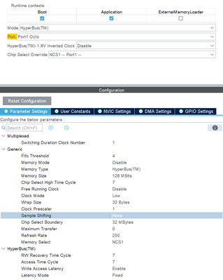

2026-02-09 9:16 AM
Thank you very much @KDJEM.1;
We tried the values from the datasheet (35ns @ 200MHz = 7 Cycles for both)
In the datasheet we found the following default values for the timing:
Initial latency: 7 Clock latency @ 200 MHz/166 MHz max frequency
Fixed latency enable: 1 - Fixed 2 times initial latency
Hybrid burst enable: 1: Wrapped burst sequence in legacy wrapped burst manner
Burst length: 32 bytes
We ended up with the following config but it still produces garbarge Data and sometimes hangs the chip:
it is unclear for us which values corrospond the the items in the list.
For example: what ist "Refresh Rate", "Maximum transfer", ...?
Is there an example maybe?
Again, thank you for your help.

Hello @dhAvionics,
Thank you.
Kaouthar
