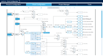

Hello @乒乓 and welcome to the ST community,
What crystal value you've attached to HSE? you should not exceed 8MHz in that configuration.
2026-01-28 12:40 AM
The external clock I configured is 8 MHz.

2026-01-28 4:13 AM
Is the crystal really 8 MHz?
The MCU might get in trouble when you configure 8 MHz but the reality is e.g. 16 MHz...
2026-01-28 4:18 AM
This is what I'm suspecting.
