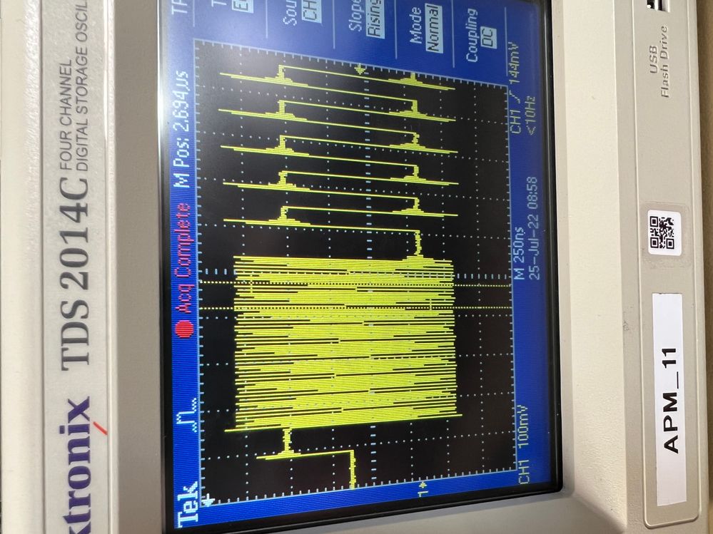

Hi I'm trying to generate a signal with 100 ns time on and 100 ns time off thanks to DMA transfer. My problem is that I have a peak of tension before and I don't know what is it (F446RE)
Here is my code:

2022-07-27 6:24 AM
I found the problem -> set pin to no pull up no pull down and -> Enable alternate fucntion of pin and timers at the end of all initialisations

2022-07-25 4:33 AM
Debug your code step by step with the scope connected and find which statement causes what behaviour.
Btw, I don't see a reason for using DMA for such a regular waveform, but you might have your reasons.
