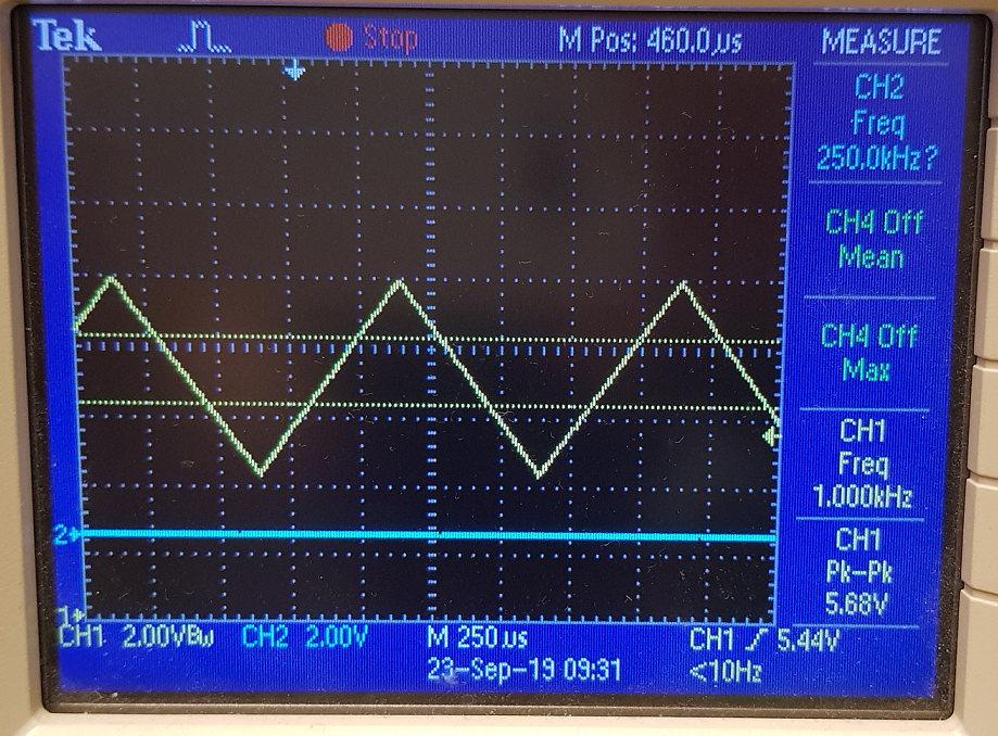

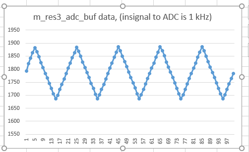

}I'm using STM32F746, and the configuring is done with the HAL-library.
In the code below there is a 40 kHz TIM4 interrupt.
The ADC1 & ADC2 is configured in multimode which is triggered by TIM1.
I also use DMA for the ADC data transfer
Each ADC samples 2 channels (ADC1: IN3, IN4), (ADC2: IN5, IN6).
TIM1 is invoked in TIM4 interrupt handler and stopped in TIM1 interrupt handler.
The 4 data from ADC1 & ADC2 are accessible in HAL_ADC_ConvCpltCallback()
The problem is that the ADCs only samples data with 20 kHz instead of 40 kHz.
I have try several different setting but I cannot increase the ADC sampling rate.
Can someone point out what I have done wrong?
As you can see I have enabled Scan Conversion Mode but disabled Continuous Conversion Mode
As I understand it, (when I read the STM32F746 user manual), it should be enough with one TIM1 trigger to the ADC, since the ADCs should the be responsible to sample all channels automatically and the invoke HAL_ADC_ConvCpltCallback() (when End of Conversion Selection = ECO flag at the end of all conversations).
I saw somewhere that someone suggested to activate the Continuous Conversion Mode to get all channels sampled when a timer is triggs the ADCs but I cannot find anything which confirms this in the STM32F746 user manual.
I have another problem too and that is that the only trigger event that is possible to use to trig the ADCs is timer 1 Trigger 2 Out Event. Why can I not use any other timer or events?
I have tried to trig the ADCs with timer 4. The settings I have tried are:
TIM4 ADC1
- TRGO update event -> Timer 2 Trigger Out Event
- Output Compare (OC1REF) -> Capture Compare 1 event
- Output Compare (OC2REF) -> Capture Compare 2 event
- Output Compare (OC3REF) -> Capture Compare 3 event
- Output Compare (OC4REF) -> Capture Compare 4 event
Nothing above are working.

The first image below shows that ADC samples only 20 samples during each period even when input signal i 1 kHz. The second image shows the input signal connected to the ADCs input channels.
2019-09-23 9:01 AM
