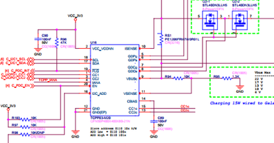

Did you implement the user code provided in this example? Would you share minimum schematics with USB C connector? Compare with reference board design to narrow down the issue.
2025-11-27 6:27 PM - edited 2025-11-27 8:01 PM
Hello FBL,
We followed https://www.youtube.com/watch?v=mJ4VX_2B6wE&t=839s , for our custom board (configured as in MX_Config.PNG, SCH.pdf).

Sorry for my late reply. Your schematics attached are pixelated and hard to read.
I see RS4 (~39 kΩ, check your exact value not clear) between VBUS and VSENSE. If the value between VBUS and VSENSE is too large or is not as per reference schematics (2–5 kΩ ), the TCPP03 can misread VBUS level.
About attach sometimes works only when plug/unplug is very fast. And when it does work, PD controller goes up to PE_SRC_SEND_CAPABILITIES, then you see a Hard Reset.
