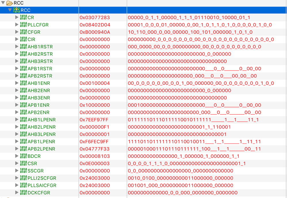

Also captured RCC register contents (see screenshot).

And the Systick registers content?
Of course, both are interesting only when the problem occurs.
PS What debugger is this?
