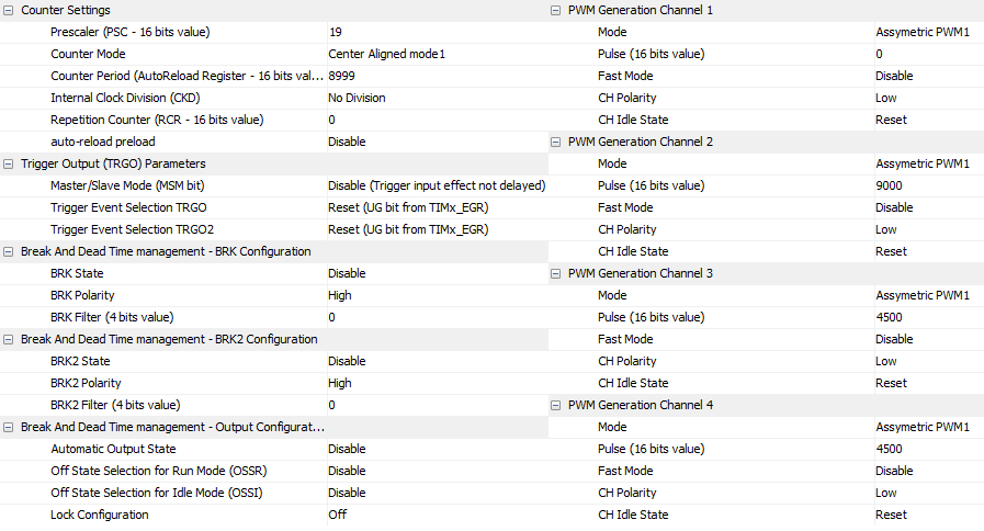

TIM1 (Simulated encoder output): 200Hz
TIM1 (CH1, CH3) output looks like this (verified with oscilloscope):

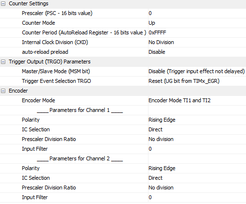

TIM3 (Encoder interface):
Using X4 encoding I expect that the TIM3 counter will be incremented once every 1250us (see picture above). However the times I get using this approach is 61-62us less. This is the ten sampled values I get (there is something in my implementation that gives a value twice as big the first time):

I changed TIM2 to this:
This way it will increment the counter once every 1us and then I use the Capture/Compare interrupt of the encoder interface (TIM3) to handle each change of the counter. Here I can check how much time has elapsed using the TIM2 counter and I now get better results:
2500, 1250, 1250, 1250, 1249, 1250, 1250, 1250, 1250, 1250
