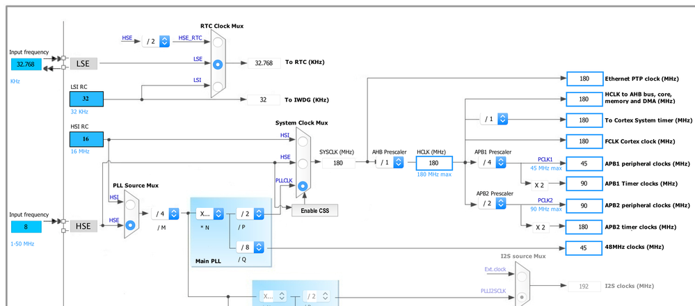

Here are the clock configs from Cube:

To be honest I have not done any calculation, I have used CubeMX to configure the clocks. The system core clock is 180 MHz. And as I mentioned these symptoms raised since I have upgraded HAL, CMSIS, etc. libraries.
