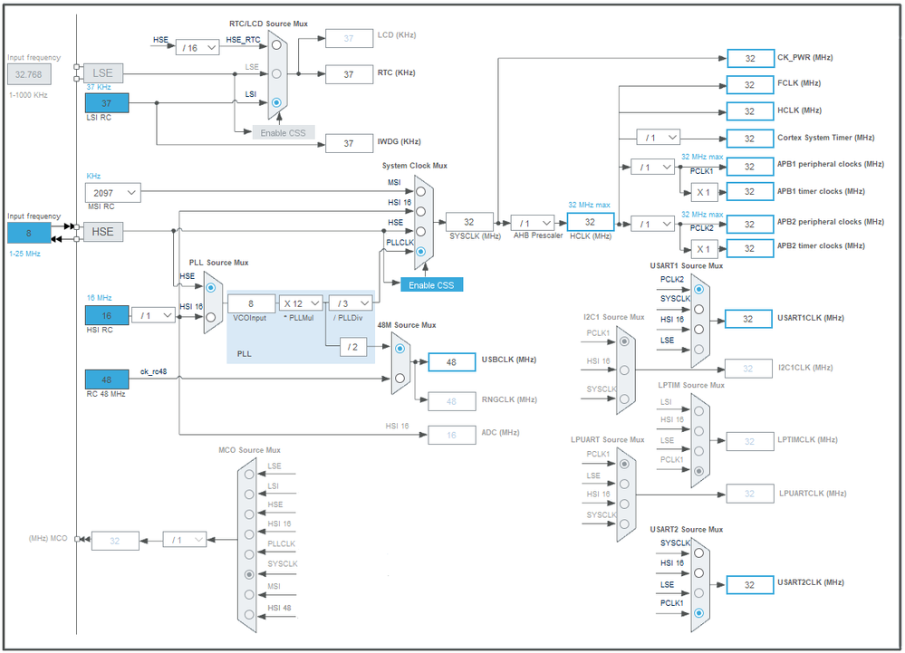

I have my own board, with STM32L053C8T6TR. And I set clock and program failed here: while (LL_RCC_HSE_IsReady ()! = 1) {};

// PLLCLK = 8MHz * 12 / 2 = 32MHz
> LL_RCC_HSE_EnableBypass();
Do you have a clock signal coming in to HSE or are you using a crystal?
2021-08-02 12:41 AM
I use a crystal. This will probably be my problem. To be sure, I'll try to check it with an oscilloscope, but I have it at work.
So I'll try to rewrite my code and remove this line.

Yes. It is true. I have my own board, but I'm testing the application on NUCLEO-L053. And I forgot about this. Here is function clock settings for nucleo or my own board.
Thank you for your advice. :smiling_face_with_smiling_eyes:
