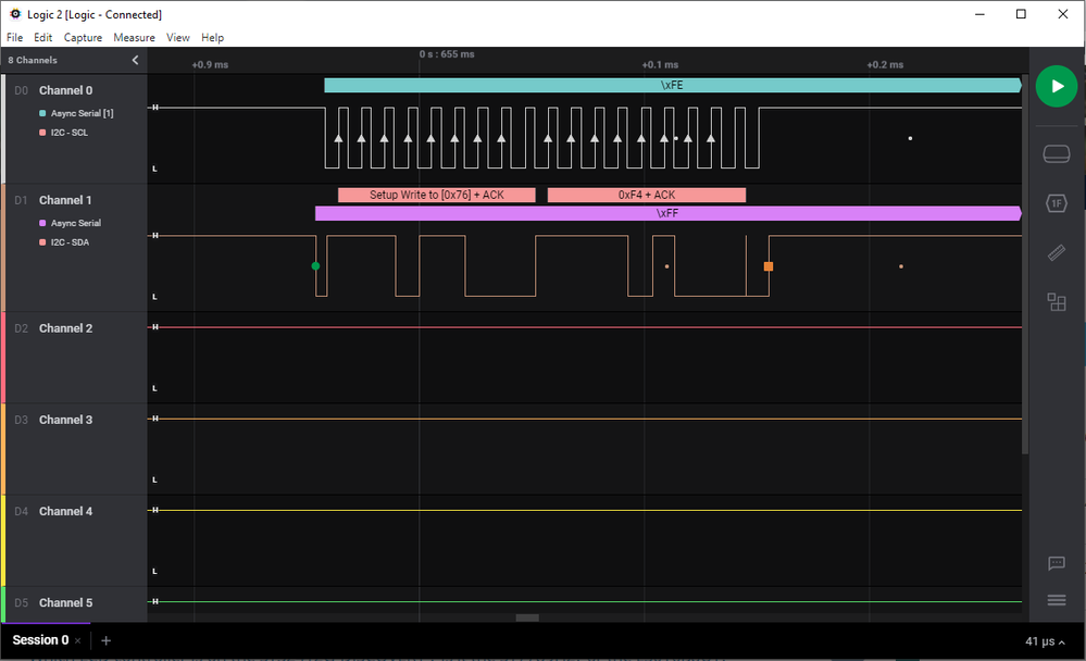

}Trying this I get the following result with the logic analyzer:
That strange glitch happens all the time, and I don't know what else I can do.

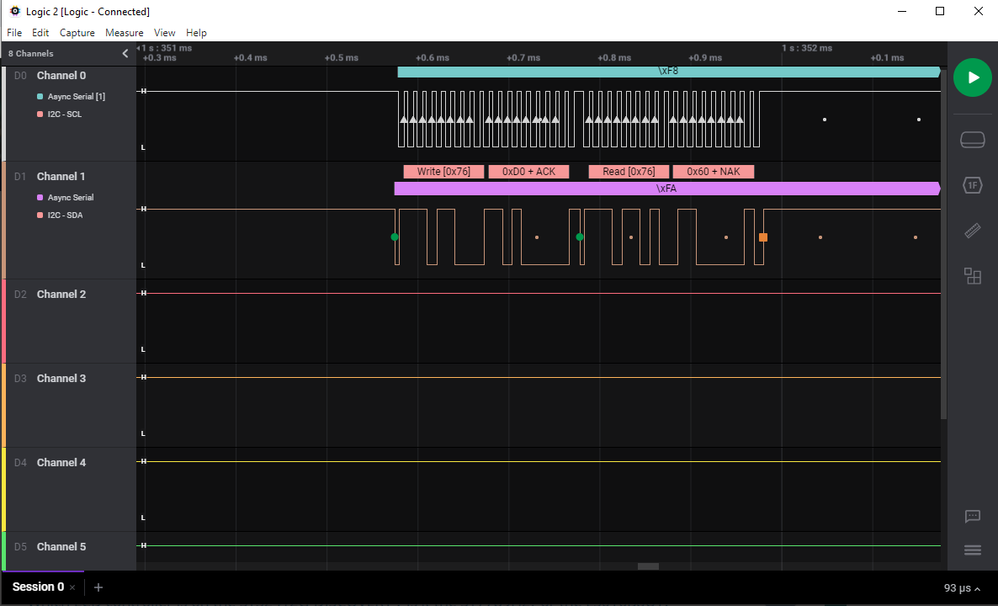

I made another function to read a register of the sensor:

utils::delay::ms(200); And the result is the following:
It works perfectly, but, even if I make a write and then a read, all the data gets distorted all over again, so, I don't know what could it be, or maybe is my logic analyzer (is one of those cheap Chinese of saelae, but for now, it has been working perfectly)

I'm trying to read data from a BME-280 sensor, in the first plot I want to write to the 0xF4 register the value 0x03, but it doesn´t show the 0x03, instead, there is like that glitch showing.
The second one is a good reading of a register from the sensor. so I think I'm having problems with the write statement, i don't know if there is a step more

well, the write function is not working that good, it shows that little glitch when I'm sending data to a register (I'm using a BME-280 sensor) I'm trying to send 0xF4(register direction) and 0x03(the data I want to write)
In the second plot, I'm reading a register that contains the ID of the device, and the function reads that register with no problem. So I think I'm having a problem with the write function.

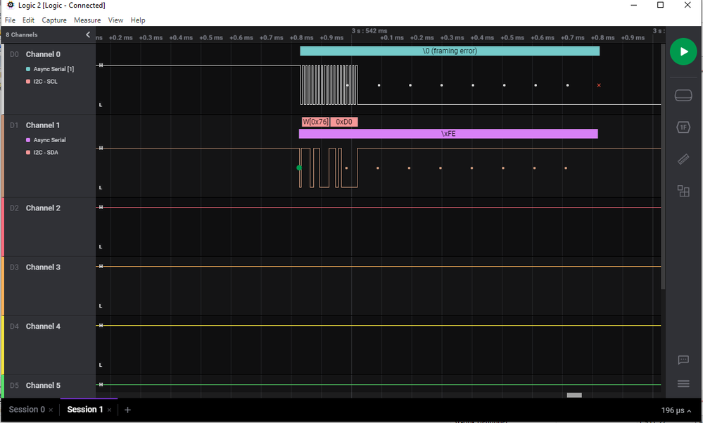

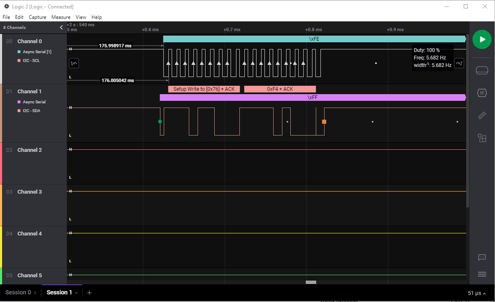

What I mean with the data is distorted is that, when I send a write function and then read a register, neither of them sends the data correctly, and then the SCL line stays low, but that only happen when I send a write and then a read, neither of them send the correct values I want to send.
example, I want to sent this information like this:
std::uint8_t data_i2c[1] = {0xD0};
std::uint8_t conf_bytes[2] = {0xF4, 0x03};
periph::I2C::write_data(I2C1, BME_ADDR, 2U, conf_bytes);
periph::I2C::read_reg(I2C1, BME_ADDR, 1U, data_i2c, 1U);so, this is when it makes the write function:
and this is when happens the read instruction:
