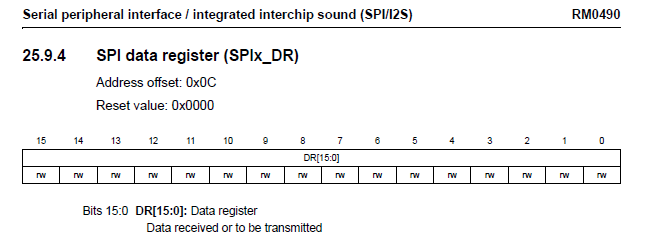

The point is, SPI->DR is 16-bit wide, not 32-bit.
This is what the reference manual says:
And then I realized almost all other registers are 16-bit as well, but defined as 32-bit.

> IIRC it can split 32-bit write to 2*16 bit or 4*8 bit entries in the TX FIFO.
I think not.
The register is 16-bit wide (according to the reference manual), and the upper half word surely goes to nirvana.
And declaring the peripheral register as 32-bit causes the toolchain to always emit a 32-bit write access if one uses DR directly.

Sorry, but I beg to disagree.
> The SPI registers are declared as 32-bit like all other registers because STM32C0 is a 32-bit Cortex M0+ MCU and all registers are 32-bit wide.
No, they are not. Just look up the reference manual.
Just because the are aligned to 32-bit word addresses does not make them 32-bit wide.
