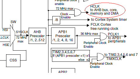

Here is the clock going to Flash it is HCLK after the AHB prescaler. With STM32F101 access line series ( 36Mhz) the flash wait state should be 1 if HCLK is greater then 24MHz. STOne-32.2011-05-17 4:51 AM

Whilst I accept the diagram shown by STOne-32, I think that the question still hasn't been resolved, so beware: Similar diagrams are shown for all devices within the family, both within datasheets and in RM0008. Within the datasheets, supply current charateristics are often quoted with the condition that the wait state setting is adjusted according to the HCLK frequency. Yet both RM0008, PM0075 (PM0042, as was) and Hitex's paper all refer to SYSCLK's frequency being used to determine the wait state setting! Come on ST, which one is it? When I see ambiguity regarding a feature, especially within the manufacturer's documentation, I get nervous! NB I have a similar thread running (alas, so far unanswered!) regarding USB on an `F105 and what settings of HCLK are allowed. I think that the two issues might be related - it would appear that this whole area of the STM32 family clock tree is not fully understood (even by ST!). Comments anyone? Regards, Mike.2011-05-17 4:51 AM
its HCLK.
for further details and computation help see AN2784
http://www.st.com/stonline/products/literature/anp/14779.pdf
i agree with you mike.shan, St documentation sucks.... there are too much things in their documentation short of description. it takes a lot of time to find the right piece of information. the only document which i like is firmware library manual which is a little better.2011-05-17 4:51 AM

However, I believe that all STM32s are the same in this matter: they actually clock the internal program ROM from SYSCLK (at least when doing instruction fetches over the internal ICode bus; it may be different when reading data (constants) over the internal DCode bus (via the BusMatrix) – the documentation is confusing – see RM0008, section 2.1 – it’s all mentioned, but not fully described!).
As I said before, when two pieces of manufacturer’s documentation contradict each other, be afraid, be very afraid – perhaps even they don’t understand it!
If program ROM is clocked from SYSCLK, then the datasheet clock tree diagrams are wrong (and the ones shown in RM0008!), and the advice that STOne-32 gave to the OP is wrong.
He said (for the `101, that can only go as fast as 36 MHz) “…the flash wait state should be 1 if HCLK is greater then 24MHz.�?, implying that as long as HCLK is less than 24 MHz, then 0 wait states are okay. I think that this is wrong advice, but as I reported last time, on a given device, and at ambient temperature, you might ‘get away with it’.
Since last time, I have repeated my experiment on my STM3210E-EVAL and got the same results. So, I’ve now tried this on three independent STM32 specimens (and each of these were different variants) and it is always the same – at SYCLK = 72 MHz, dropping to 0 wait states always crashes, even if HCLK is set to SYSCLK /4 = 18 MHz, which, according to the datasheet diagrams, should not need any wait states.
